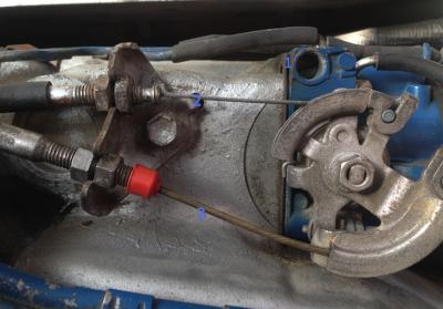

Kickdown and throttle/idle adjustement
So I am having a couple of issues on my 87 4YE 4wd van One is that my tranny shifts too high and jerky (I have to let go of gas to get it to shift "normally") and I am not sure of my idle adjustement. I understand that the tranny is adjusted by the kickdown cable but the only instructions I found are not relevant to what I see (there is another post here - guy had same issue - diagram in book refers adjusting cable until some stopper was in right place but I don't see anything like that).
The other is the idle - the book says to use a screw with a rubber stop - I don't seem to have that but I do see a screw near the top. However I had a buddy adjust my idle speed with the top cable so I am a little confused as to what is the correct way.
I've attached a pic of what I see. is #1 the idle screw? So how do I adjust the 2 cables?
Attachment 2854
Re: Kickdown and throttle/idle adjustement
I can tell you that #1 is indeed the idle adjustment screw.I would be very interested in the results of your tranny shifting issue, as my 86 2wd has a similar problem. There are 2 procedures I have seen for adjusting the cable, one using the stopper on the cable, one for a new cable that has no stopper. Neither one seems to completely cure my issue. I have an 85 that shifts perfectly, with 225 k on it.

I've got a similar issue unfortunately I don't have a rubber boot on my cable. Suggestions on how to adjust it? I've toyed around with it but not sure I have it right as my tranny doesn't quite shift as I think it should.

As far as the adjustment goes using the 1mm stopper in relation to the boot when the cable is fully extended becomes irrelevant and is not a reliable indicator as these cables "stretch" over time. New replacement cables when they were available did not have this stopper staked to the cable.
I adjust it by feel. The following is my guide that I have used for years for upshifts
25% throttle 1-2 @ 10 mph 2-3 @ 25 mph 3-OD @ 30 mph
50% throttle 1-2 @ 15 mph 2-3 @ 30 mph 3-OD @ 35 mph
75% Throttle 1-2 @ 20 mph 2-3 @ 35 mph 3- OD@ 40 mph
100% throttle 1-2 @ 28 mph 2-3 @ 50 mph
According to the manual a 3-OD upshift will never occur with a throttle opening of 86% or greater
Hint when the cable is adjusted so that it is closer to the driver side will make the transmission up shift sooner.
If you adjust the cable until there is no threads showing below the red arrow you should get early up shifts
if you adjust the cable until the there is no threads showing below the blue arrow and the adjusting nut is touching the boot you will get very late up shifts
if you notice I have about 4.5 threads on the red arrow side and about 5 threads on the blue arrow sides basically I am adjusted right in the middle and that pretty much works if you have a healthy cable. This where I Have had most of my Vans adjusted

UPDATE : Part number changed. Here is the contact for Bernard. The replacement cable is longer but it works fine. Just make sure it is not kinked when installed and the cost is 50 bucks. Let them know I sent you if you buy it thanks

Hey JPERL:
Can you upload your picture of you kick down adjustments with the arrows you stated? The pics don't seem to want to come up.
Thank you
Re: automatic transmission: delayed, jerky shifts. throttle (kick-down) cable adjustm
JPERL: No worries, I was able to get it by changing web formats.
