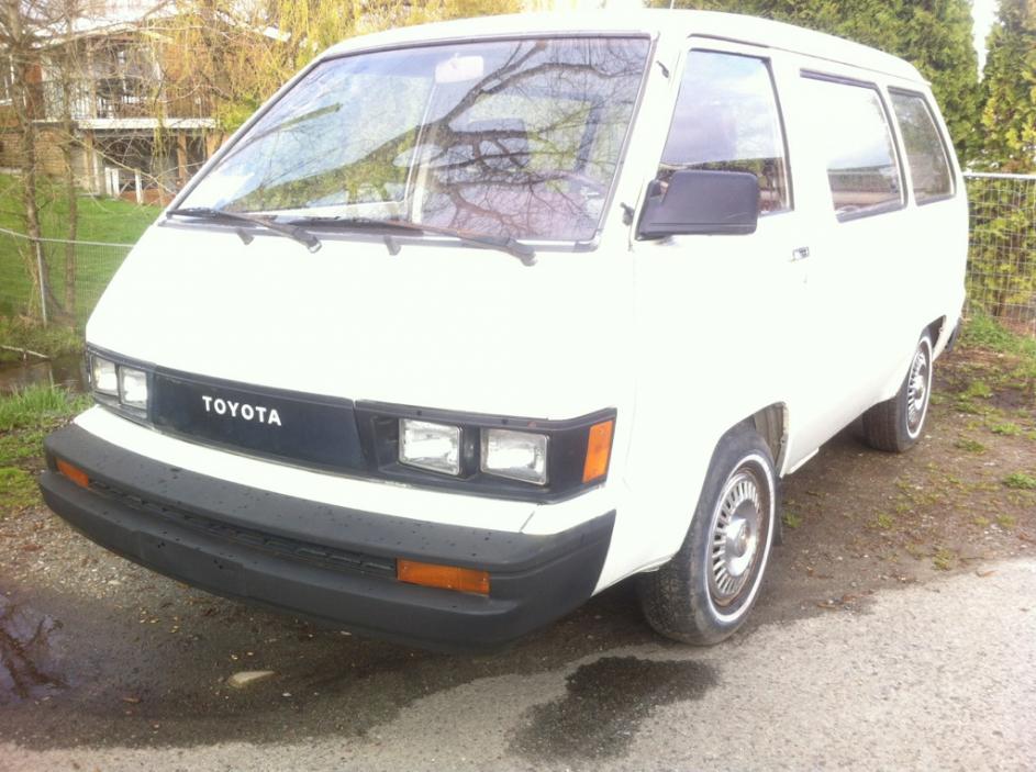

So after some research on this wonderful forum, I think Ive found my issue with the toyota van. Yesterday I ran the tank on E to the gas station, then suddenly it started miss-firing terribly. We did some troubleshooting, full compression and spark, but no go on cylinder #3. I suspected a bad fuel injector, but there must be more chance of fouling the third cylinder injector. Wished it was just the spark plug but Im happy I've pretty much found my solution. So far Ive put over 2500kms on it. I changed the fuel pump (fouled) and front tires, and its been reliable until now. I love these vans, they're just so unique!:dance2:
PS: Anyone have parts in BC for this van? I need;
Fuel injector (3rd cylinder)
gas cap door
center console piece (Red?)
front rotors
Attachment 1677
