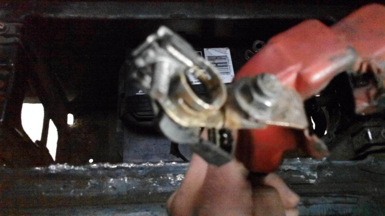

Re: Ignition switch question.
I started at the battery posts and disconnected the battery at the negative post. The negative connection is clean and fine. The positive post has a mounting plate on a thin plastic base that secures to the positive battery post. The plate has two places that 5, in total, wires are connected to the positive terminal. The mounting plate has a 10 mm nut and bolt, moves horizontally, that secures the clamp to the positive post and connects the 4 small wires that lead to the fusible links and alternator. On the other side of the mounting plate there is a 12 mm bolt that moves vertically up and down that secures the beefy wire connected with a crimped on brass fitting. I assume that this beefy wire goes to the starter?. On my positive post clamp between the 12mm bolt and the sleeve that goes over the positive post the brass mounting plate has what looks like a cut in it. The brass mounting plate is around 3/4" wide and 1/16" thick only about half of it is conducting electricity.
I took it to the Toyota dealer and they said that the part is not made any more. I went to look at one of two vans that I have seen in yards and the positive clamp was gone. Is there a more modern connector that I could replace this with?/or would it be better to keep searching at salvage yards for a used one?

5 Attachment(s)
And the results are in.
Attachment 1834
Ground wire issues. Not the ones most users would think of. With a couple of amps, inverter, and a dedicated charging solenoid, all hooked up to a marine battery.

Quoting myself here to thank Tim again for the oversight on my end. I'm also quoting myself here because I didn't include body shots of the toaster in this thread. . Being a man of my word and thankful for all the issues he(and others) have helped me resolve, and knowing in other threads, Tim has expressed interest in owning a cargo van I fell complied to post thetoaster in full frontal. So here's the rest of my 89 cargo van(2wd:violn:).
Attachment 1847
Attachment 1845
Attachment 1846
Attachment 1848
Sorry about the photos taking with my phone being horizontally challenged. Rest assured I'm on the phone with Google, the NSA, and the sites servers to find out who is really to blame for this visual blunder. lol
