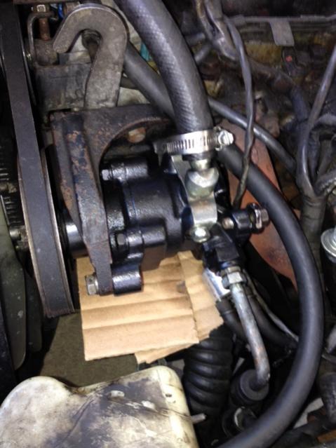

So my mechanic decided to weld the bottom instead of sticking a screw in there. It is still leaking now after installed but less then it was before. For some reasons the steering has become jerky and rough since this job and I was wondering if that hole is necessary for the pump to work right? Who knows, but maybe it is my actual power steering resevior that is clogged up and needs to be cleaned out since it has never been done. But it wasnt this bad before.
Attachment 1110
So its been almost two weeks since I installed this new/reman pump from BBB industries and I'm proud to say it is not leaking.
This can be a viable option for those who want to replace their pumps with a good one. I spent the extra $20-$30 and got this one because of all the issues I had with my other one.
With my other one we started of buying a seal kit from ebay. We were able to stop 99% of the leaks except for the one at the bottom which leaked through the wheep hole. Then we removed the pump again and my mechanic welded it shut. It didnt work and was still leaking. This is the best way.
Also I plan to keep those cardboard pieces there so if it ever starts leaking again this is a good indication.
