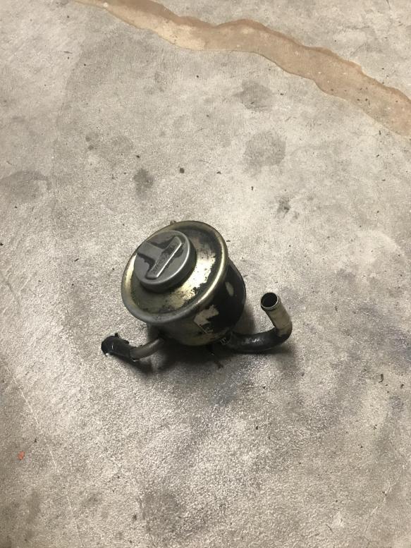

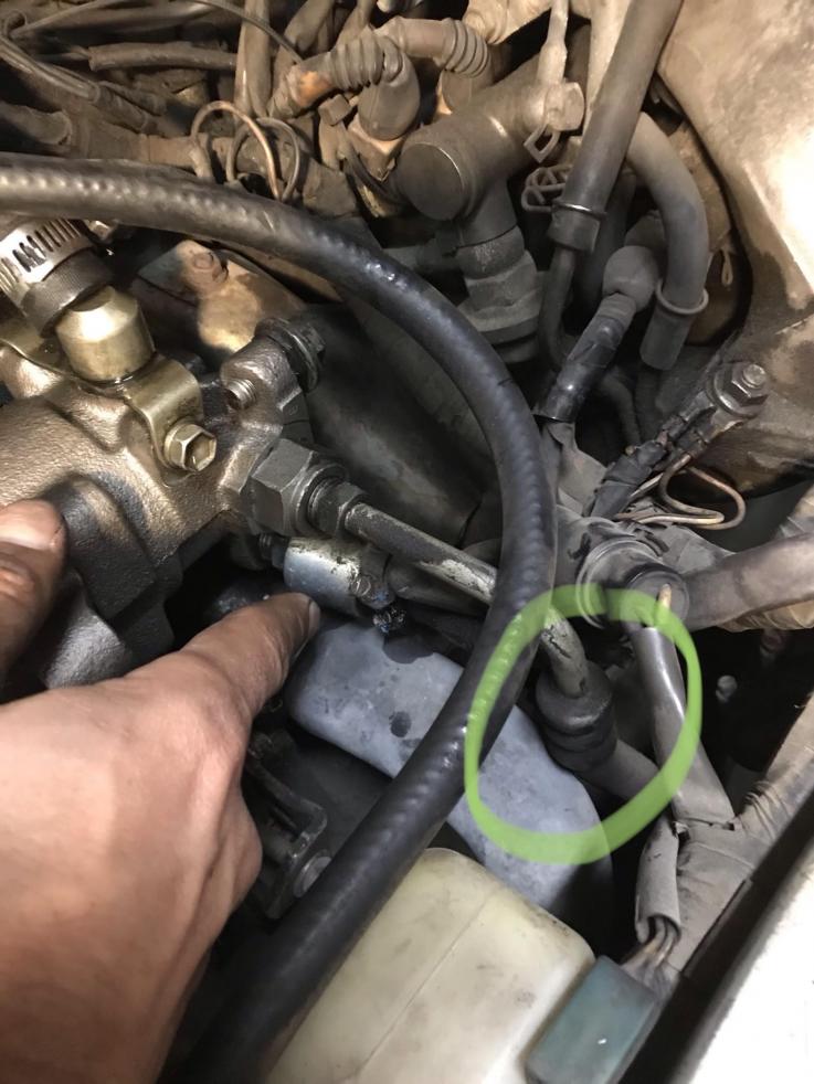

Hello everyone,
So I'm getting some noises when Im turning my steering wheel and there is a small small leak at the top of the pump. I'm planning to clean my PS reservoir / screen and change my o-ring. I have a question please and I'm adding some pictures here as well. Is my "pressure line from the rack" like Tim mentioned in his first post, where i have cycle it with green in my picture?
Thank you very much!
Attachment 9914Attachment 9916Attachment 9915

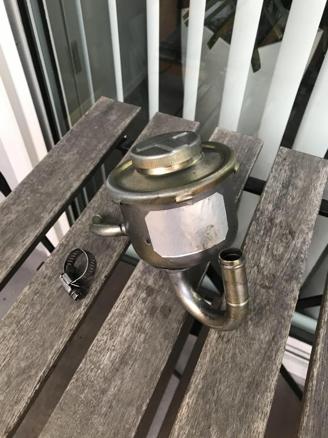

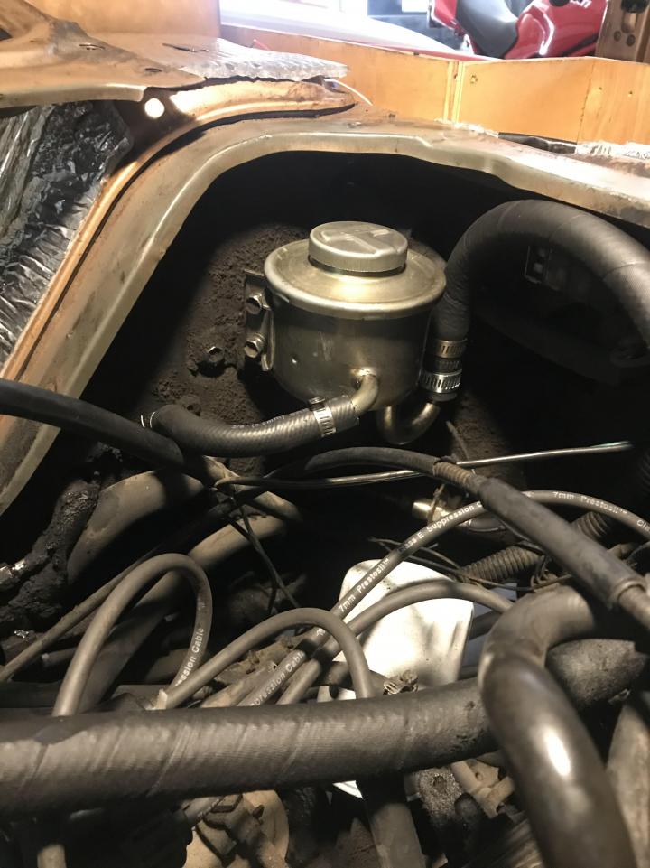

Burntboot thank you for your quick reply,
When I removed my PS reservoir it's was really dirty, I used a Paint Thinner with a toothbrush to clean it. When I opened the cap, the screen was broken in half and I took it off so I can clean everything inside as well. I noticed for '84 Vans the screen is one part with the reservoir and not 2 different parts like I saw some pics here.
I couldn't find the way to upload a video here, but I'm adding a link with the noise. Attached some pics
https://www.dropbox.com/s/kpvoizxredy2t4g/IMG_0098.MOV?dl=0
Thank you!
Attachment 9936 Attachment 9937 Attachment 9938 Attachment 9939
Re: Power steering system noise?
FYI - Your reservoir looks the same as the later ones and neither are intended to come apart.
The "lid" is held on with metal tabs bent under, unbending the tabs is all thats required to separate the housing and access the screen.
Burnboot, yes I removed the cap with a screwdriver and I cleaned the inside of my reservoir as well. I noticed with my PS reservoir, the screen was connected around the metal and it wasn’t 2 different parts like pics I have seen here, also it was broken in half. So I decided to take the screen off and cleaned the bottom of the reservoir..
Now I’m looking for a new reservoir with screen or keep my fluid clean by flushing the system more often.. unfortunately I didn’t take a pic with my screen broken.

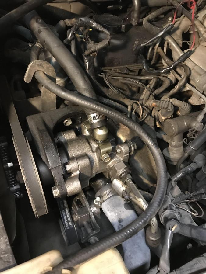

Hey, gang! Its been a long time but I'm finally working on my '89 4wd again.
Sometime last year I disassembled my power steering reservoir to help with some intermittent whining and loss of steering.
This did help tremendously however I did notice at times when the van was idling the ps-pulley would seize up, so I decided to replace the pump itself.
Fast-forward a year and I finally got the pump switched out and the lines flushed with new Dex-III!
I've spent HOURS bleeding my steering system to get any air out (I installed a temporary clear tube so I could watch the AFT fluid as it cleared)
I've inspected the lines and nothing is obviously kinked or has failed and the new pump isn't leaking anywhere and there is no noise.
When the wheels are off the ground the wheel turns buttery-smooth but when I've got wheels touching there is a ton of resistance in the system.
I've got the reservoir filled to appropriate levels but I have noticed that the reservoir fills faster than it empties.
The ps pump was a remanufacture and I'm beginning to think that its a dud. At least that's what I'm hoping for at this point!
Before I go ripping it out again I've got some suspicions...
1) the inside of one of the lines has collapsed. I haven't replaced them so as far as I know they are OE and maybe are restricting flow or letting air into the system.
2) I really botched the pump install and maybe ruined the banjo fitting? Doesn't seem likely..
or 3) I need a rack-rebuild :(
Anything you could offer at this point would be so appreciated!

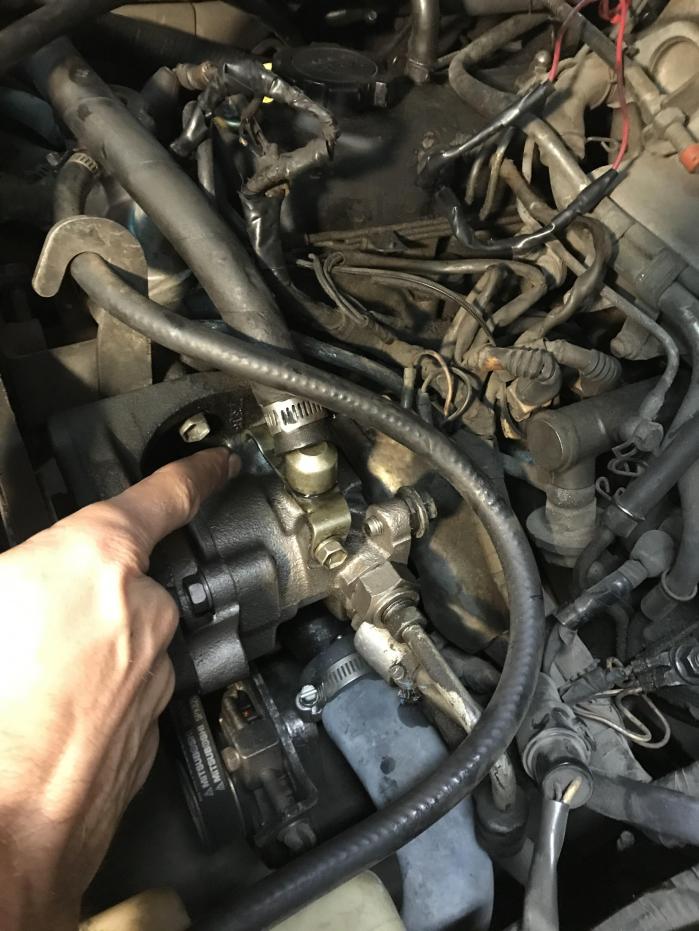

Anyone ever have power steering system making a rattling/loud ticking ( almost like a stuck lifter) type noise? Mine has had this noise ever since I owned the van. A little background, the PS fluid is full with Dex III, I have changed the idler pulley, and tried different tensions on the PS belt. I know it is the PS cause I have taken of the belt and ran the motor and the rattle goes away. Maybe the belt was tensioned to much for to long and wore out the PS pump bearings? Curious to hear if anyone has had this problem and resolved it by replacing the pump?
Well I took a closer look at the PS pump. I found that there is a dent in the PS pump pulley v-groove. This dent makes a bump where the belt slots into the pulley. I think the noise that I am hearing is chatter from the belt tracking over the dent in the pulley. A new pulley is 170$ uggh! There is a van at a salvage yard near me, but they won’t sell the pulley alone and want 120.00 for the pulley and pump.
Can you file/sand out the dent? Just make sure there are no sharp edges.
