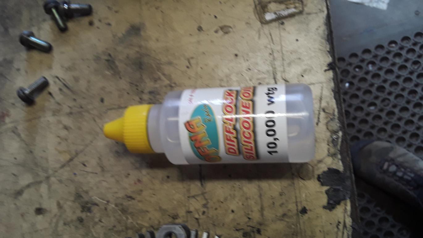

decided i wanted to play around with a dead aisin fan clutch and did some research, land cruiser guys are using what called diff fluid for rc cars/trucks, its silicone and comes in many weights, and sold at hobby stores..most of the guys were using 10,000 cst weight oil, this ofna brand was the cheapest ($10 delivered for 4oz), looked of similar vicosity to a video i watched a guy using the actual toyota fluid...anyway i used about 2oz half the bottle, my clutch was pretty dry when i split it. fortunately all my clutches are working well at this time so ill have to get back on a report, but i think this could be a lifesaver if you were over heating out in the baran desert and needed to have the fan do more for you...
