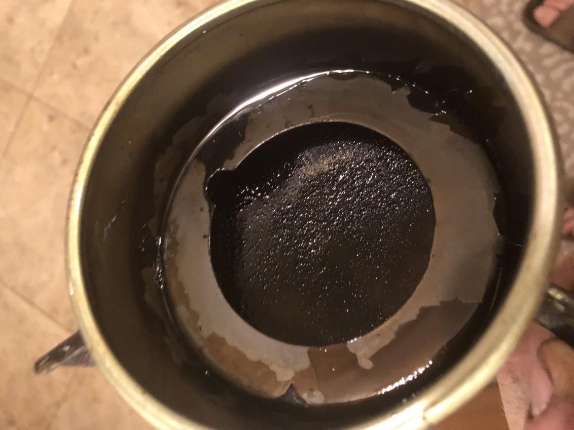

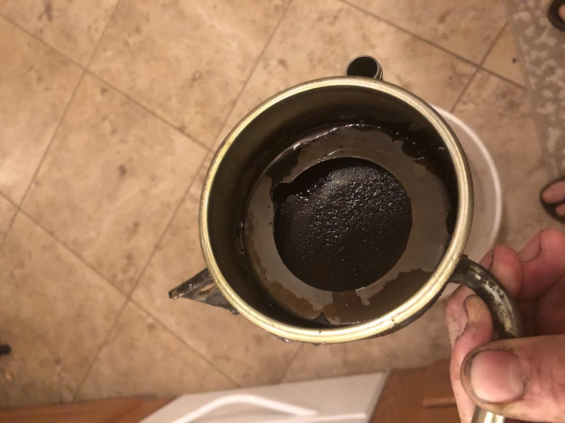

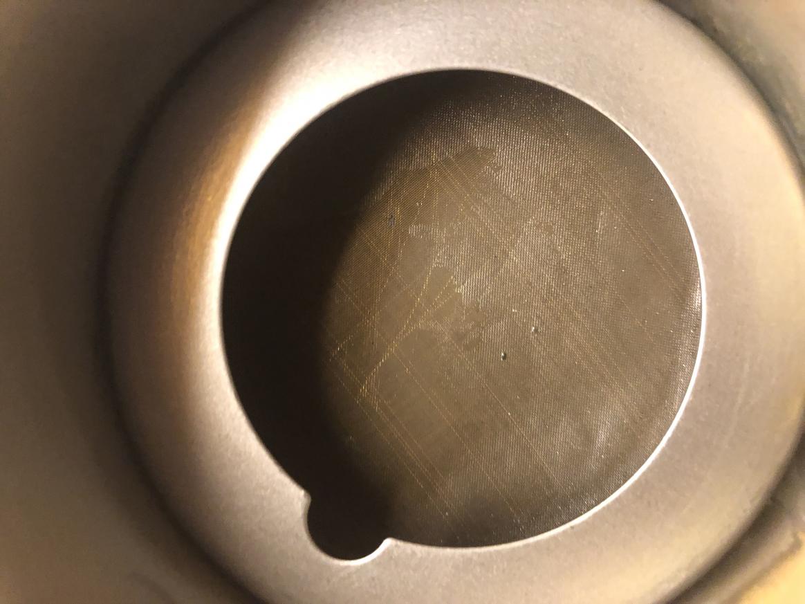

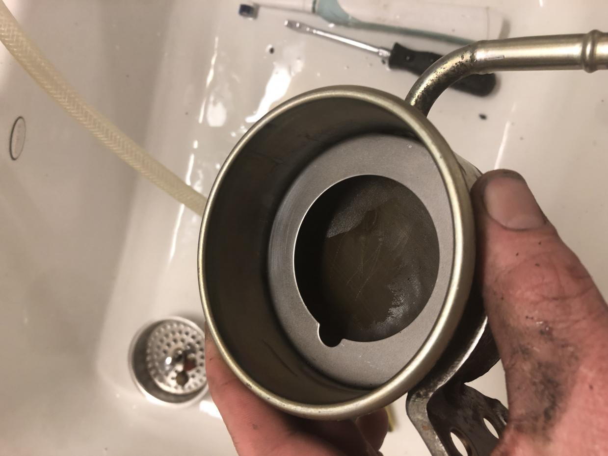

The new pulley resolved the noise. Wow what a difference! While I was at it I replaced the PS return hose with 19/32 PCV hose and took apart the reservoir and cleaned the screen. After I was finished the PS pump was making a terrible noise and found out that I had foamed the ATF fluid. I ended up needing to go through the process of removing the air in the lines. The manual describes the method pretty well. It took starting and stopping the motor 10 times to get most of it out. It took about 2 extra quarts of ATF fluid to complete this process. I think STP ATF fluid STPDEXMERC1Q is a good product to use when looking for a substitute for DEX II. It says suitable for applications where DEX II and III are called for.
