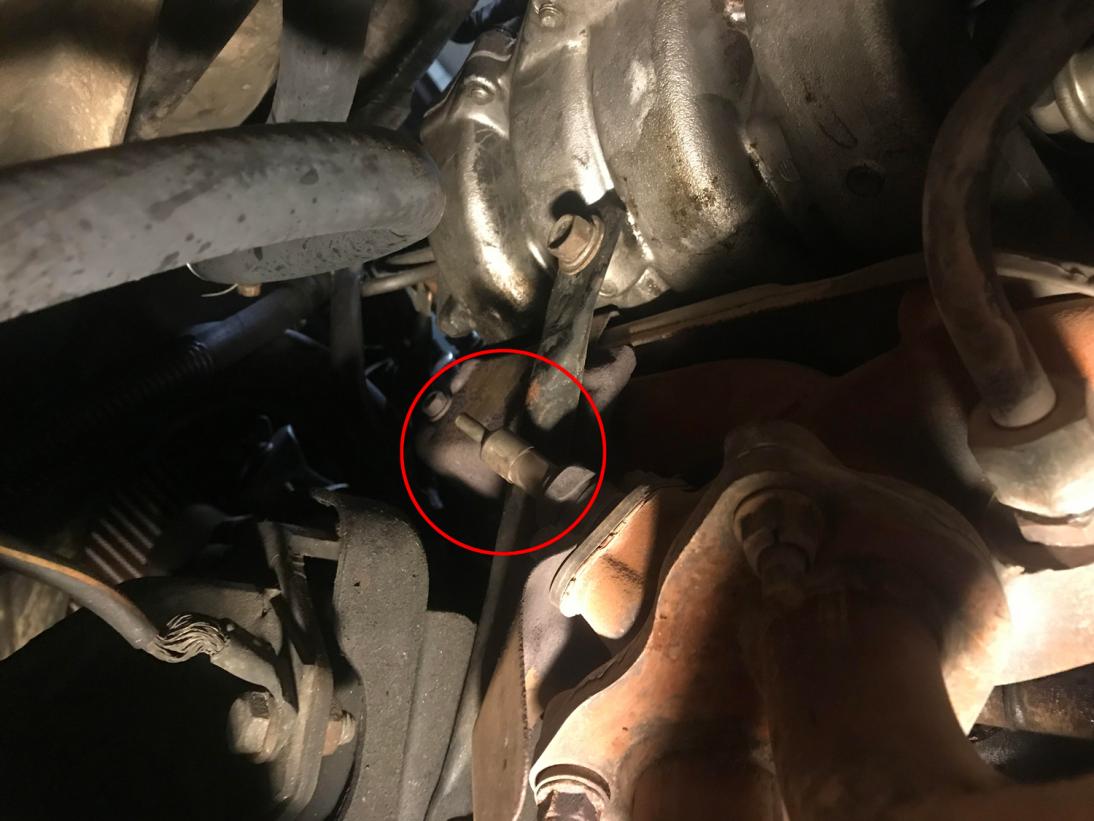

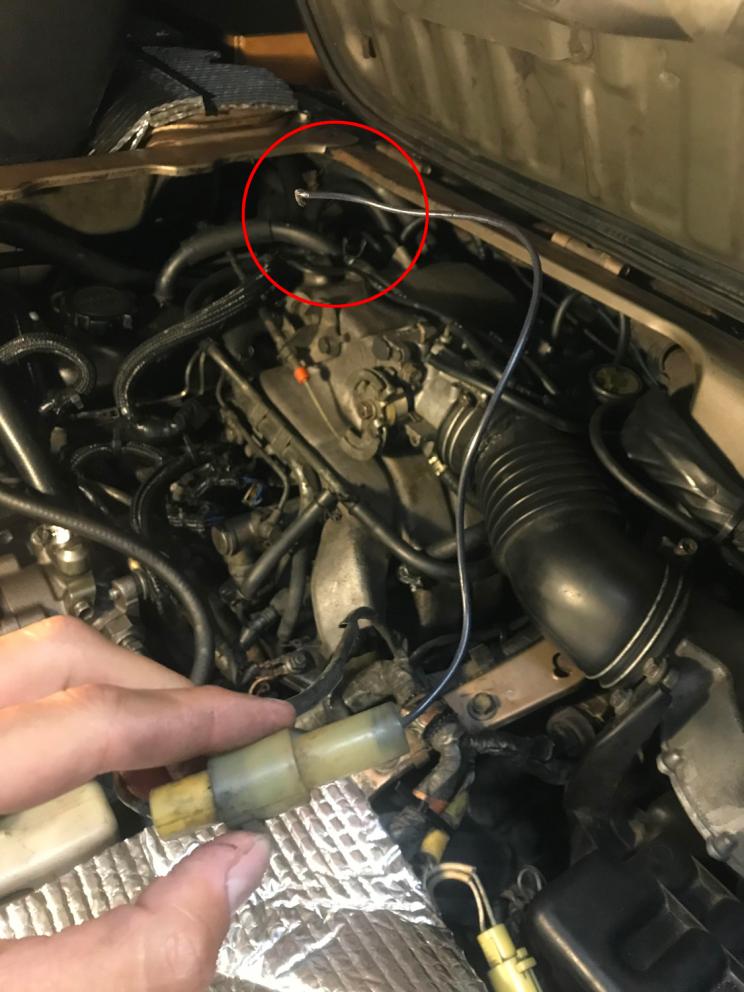

Today I checked under my Van and I noticed my 02 sensor is broken and looks like always was broken. But I have never had a check light on and off when i was driving.
A month ago, I cleaned my Throttle Body, replaced and adjusted a new TPS, replaced all my vacuum hoses and my mechanic replaced the fuel injectors.
I noticed the van is ruining way better, faster and smoother.
So I was wondering if all these changes have to do with it?

Every little bit helps. The van ECU has a "default" mode that it goes into when it can't see data from sensors. Because running too lean can damage the engine, the default mode makes it run rich. Rich running engines get poor fuel economy, run dirty and do not perform well. If left to run rich too long, other bad things happen like plugged up cat converters and fowled spark plugs. By repairing/replacing you are giving the ECU back the basic tools it needs to do it's job correctly. I suspect you will notice a MAJOR improvement in power and fuel economy when you get a good o2 sensor in there. Tim
Amazing! Thanks again Tim! :thmbup:
