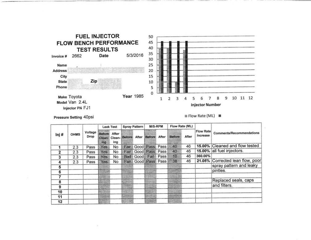

I just got my fuel injectors back from Dr. Injector and I'm pretty excited with the results. One of the fuel injectors (injector for cylinder 2) failed the spray pattern test, failed the mL/second test, and had a flow rate of 10mL. The other had a flow rate of about 40mL!!! After cleaning them, I had a 360% increase in flow rate in the one injector. That was the issue. Very little fuel to cylinder 2. :dance2:I attached the results to this post, in case anyone wants to see.
Attachment 3749
Now...to get this thing back together.
