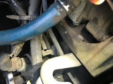

Part/part number? would this affect idle speed? Replaced valve cover gasket and looks like this got broke in the process. Idleing in start up at close to 1800rpm. 88 4wd manual.
That's your "Idle-up VSV" Toyota part number 90910-12003. Unfortunately it has been discontinued, so your only option will likely be to pull one from a salvaged van and/or use one of those salvage yard part locator sites. For more information on what it does, here's a good thread:

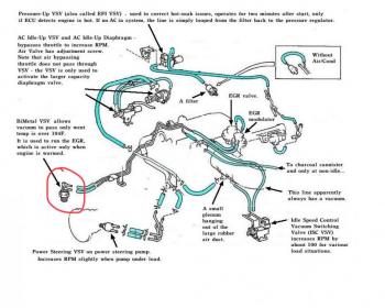

Any idea if there is a functional difference between Idle-up VSV 90910-12003 vs 90910-12005? I searched ToyoDIY and it appears it has the same application just a different last digit.
Attachment 9721
If it'll work, I have one on the workbench next to me whatvan if you need it, just let me know.
Not sure. It's very possible, even likely there are multiple VSV's used by Toyota (and others) with the exact same function. I'm guessing the only difference between some may be the configuration of the mounting bracket. If you find one that you think may work, you can test to see if it's functionally identical. Just try blowing through the nipples to see if air flows (normally open) or if it does not flow (normally closed), then activate it with 12V and blow again. Once you know how it functions you can test other similar type VSV's found elsewhere (even on other makes and models of cars). If/when you find one that functions the same way you could use that. If it doesn't mount the same you could wire tie it up or just let it dangle from the wires/vacuum hoses. Tim
