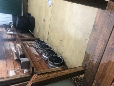

Are these snowflake wheels? Attachment 8306
They are said to be 114x4 6'' wide off a corolla gt with poorly done paint.
Kombi
Attachment 8306
https://www.toyotavantech.com/forum/...4206#post14206
Kombi,
its it’s hard to tell what those rims are in the photo even if I enlarge/explode the photo it gets too blurry for me to tell.
Check out the redirect that Tim provided, you’ve posted in that thread. Go to page 1 posting #9 the first picture is snowflake rims and also check out page 2 posting #36 those are some that I picked up.
If you can post better pictures that would be helpful:thmbup:

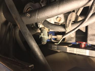

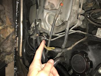

I think you are correct. The resolution is not very good but the only thing there is the cold start valve, at least in that area.
The second one looks like the wire that use to go to the pressure up temp sender. This would only be there if the van has AC.
My two cents
