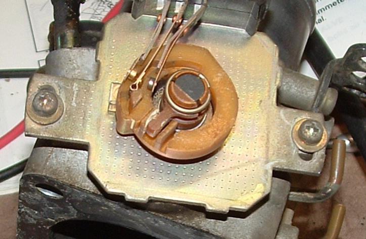

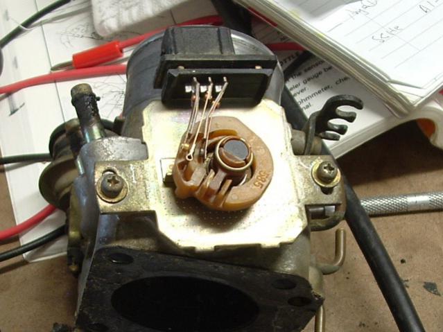

After pulling the throttle body today, I attempted to figure out what actually failed on the TPS.
after removing the cover the problem was glaringly obvious, the plastic arm was wearing its two contacts so bad, there was way too much slop, and the points could not be calibrated anymore. The plastic is also turning to powder, accelerating the wear.
The joy of desert living. Then again, this has 186K on it and it's 25 years old almost. Onwards and upwards!Attachment 664Attachment 665Attachment 666

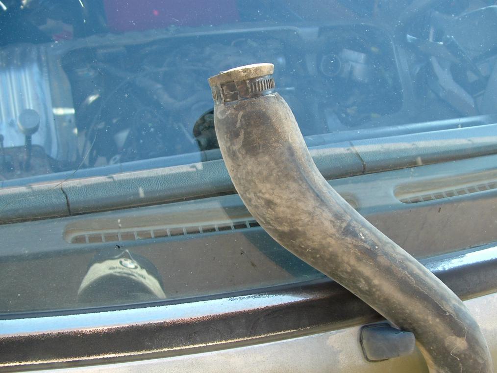

As anyone in a warm climate ever bypassed the cooling hose that run through the throttle body?
Is it really necessary, or just an exercise in over-engineering?
ANd last but not least, can you use standard 5/16 hose there or are the bends too much?
Re: A double whammy I didn't need this morning!
In most of the places you can use bulk 5/16" hose. There's 1 or 2 that I'd worry about kinking, so probably best to use the formed hoses there. I buy bulk hose by the roll and I save the stuff at the inside of the roll for these tight bends.
Depending on your climate you could "bypass the bypass" without issue. You would lose the faster idle speed when cold and may possibly develop icing problems in the throttle body (the bypass hoses provide heat to this area to prevent icing). If you're in a "tropical" climate then no problem.
