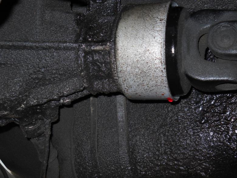

Attachment 601
okay, so I checked all of this except for the pan, because when I topped off the transmission fluid (it was a little low), the behavior pretty much stopped. A little lag shifting to 3rd, but the lurching while idling in gear stopped, and 1st to 2nd seemed pretty normal. Here is a picture of my leak. Excuse my ignorance but it's at the joint right behind the pan. Could it be coming from the pan, new gasket seal? Or is it safe to assume there is a seal inside of this silver joint that is leaking? Would be great if this is simple of course! I still hear some clanking around in there though....
truth be told I probably can't take on a huge project with this, so I might post it up for sale... its in really nice shape otherwise..
thanks for the help!
Re: newbie needs advice re: brakes and transmission
Yeah, transmissions resent being run low and ATF and will retaliate by doing what yours did. That looks like a tail shaft seal leak. Those are typically pretty easy to replace. You could do yourself but you'll need a seal puller to get the old one off and a driver to get the new one back on. Rather than buying that stuff or trying to scrounge up/make something I'd probably just take it into a transmission shop. The seal is about $10 and labor to install shouldn't be more than 1 hr. Depending on their hourly rate I'd suspect you're looking at around $100 - $150 tops. Good luck. Tim
