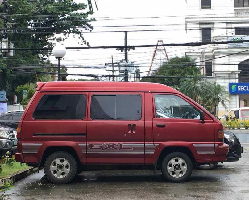

Hi all, new here. I have owned this little Toyota Liteace for a couple of months, cousins with US van you could say. In this van (2WD) is a coil-sprung rear axle with multi links. Since day 1, I have been trying to track down the source of a clunk, which is in the back half of the van when going over bumps.
