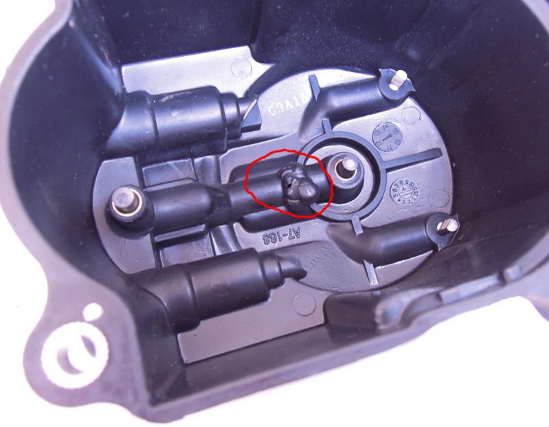

My problems have been after it's been really rainy and windy, rather than from driving in the rain, which makes me think wind is blowing it up into the breather hole.
After I've had these problems, I looked at the distributor cap and it was somewhat melted. This has happened on 2 caps.
I have cleaned off the gasket and it looks good before installing a new cap, so I don't know if it the gasket, although I should probably buy a new one. But if water is getting blown from underneath, it seems like it would go through the breather hole just as easily as a bad gasket.
Here is my melted distributor cap. This might be due to moisture on the rotor, causing it to arch around the plastic
Attachment 7803

I've melted multiple caps on my van running MSD ignition. High plug wire resistance is the biggest cause. I ended up running custom plug wires and only Toyota caps.
The vent holes are not your problem. Look for something else.
