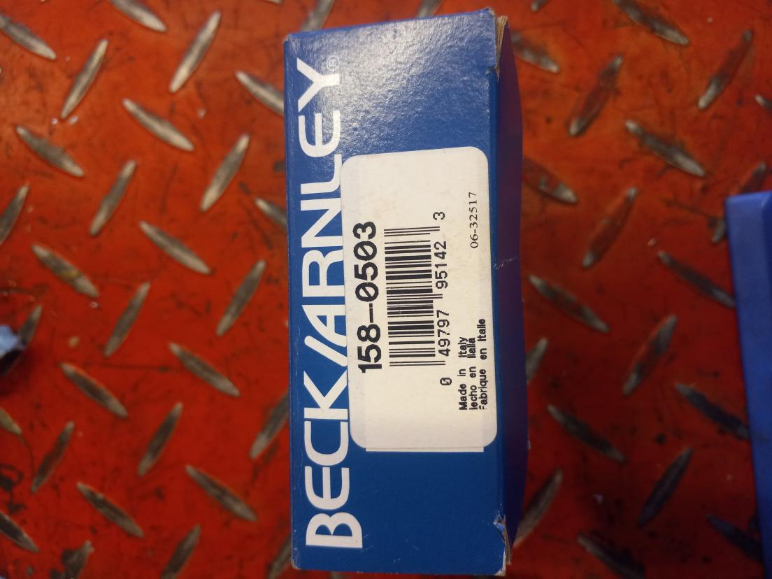

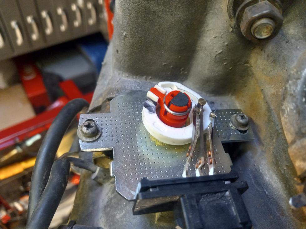

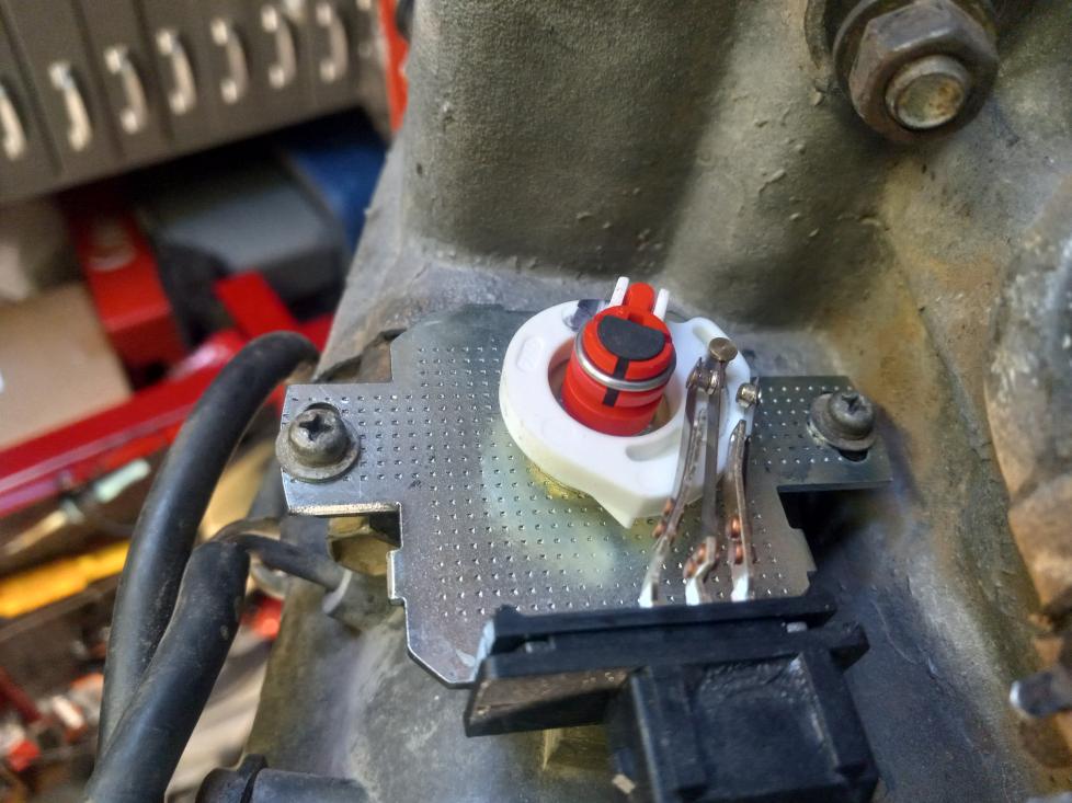

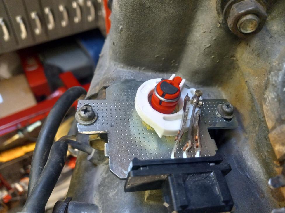

Attachment 11881Attachment 11882Attachment 11883Attachment 11884
so finally getting around to my fresh engine swap and decided its time to replace my tps with a beck and arnley unit...set idle up with no issues but when checking for wide open throttle i was getting continuity between the E1 and PSW terminals at only a few degrees past closed throttle. as i continue past this point towards WOT it loses continuity but does regain continuity just before WOT like it should. my oem tps does not do this and it seems like this would cause a running issue. the beck/arnley tps part number jives...pictures show on the idle stop, a few degrees past idle, and wide open throttle...bad part? non issue? tempted to die grind the plastic cam actuator..way past return window...
edit: solution was to slightly bend the psw arm up,. away from the e1 contact. does anyone know what the computer does when the tps is at wot? im assuming this would have caused a running issue and maybe a code, but lesson is to check both off idle and wot settings. just glad i didnt have to take this throttle body back off after install.
