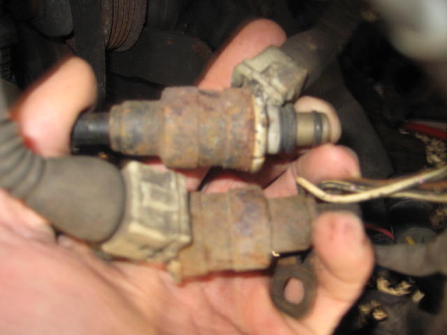

Checked the EFI fuse near the fuse box. It was blown. I guess it went under pressure while doing the whole process. Replaced the blown fuse and the fuel pump started working again. Now I have 4 rebuilt fuel injectors installed and somehow the van is running on 2-3 cylinders. He told me that since my connectors are already messed up I should get a new connector wiring harness that goes to the fuel injectors. Does anyone know if Toyota Still stocks these?
Attachment 367
I found a picture online of how the connectors on mine look and above is it. For an 86.

My diagnosis of my van feeling like it was running on two cylinders was 100% correct. Took the 4 rebuilt injectors out and tested them. Two of them clicked, two of them didnt. Be careful when buying from Ebay. Always test the injectors before believing some of the BS EBAY ad of how they were tested etc.
Easy way to test is get a USB cord splice it and connect it to the ends with the other end hooked up to power.
