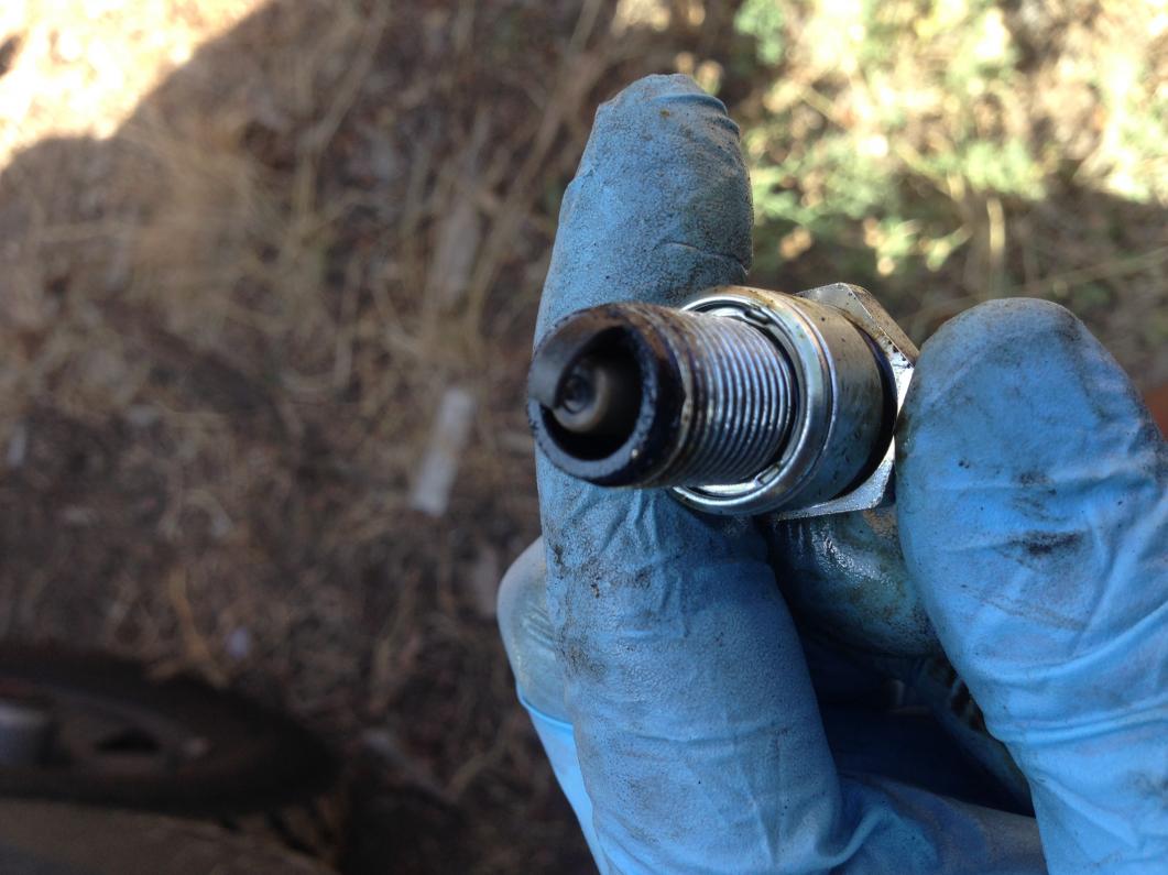

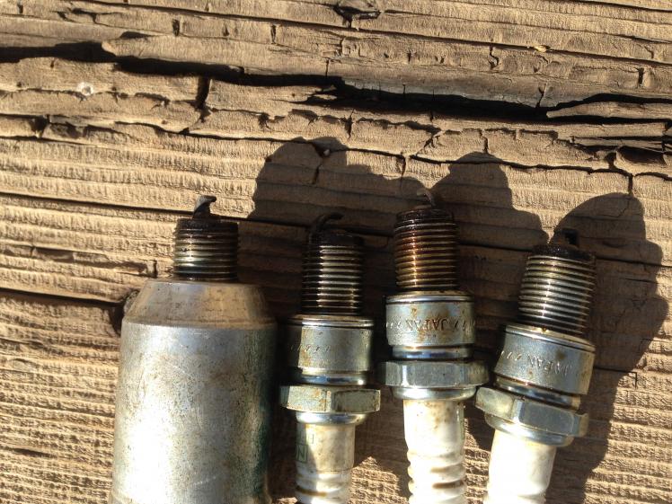

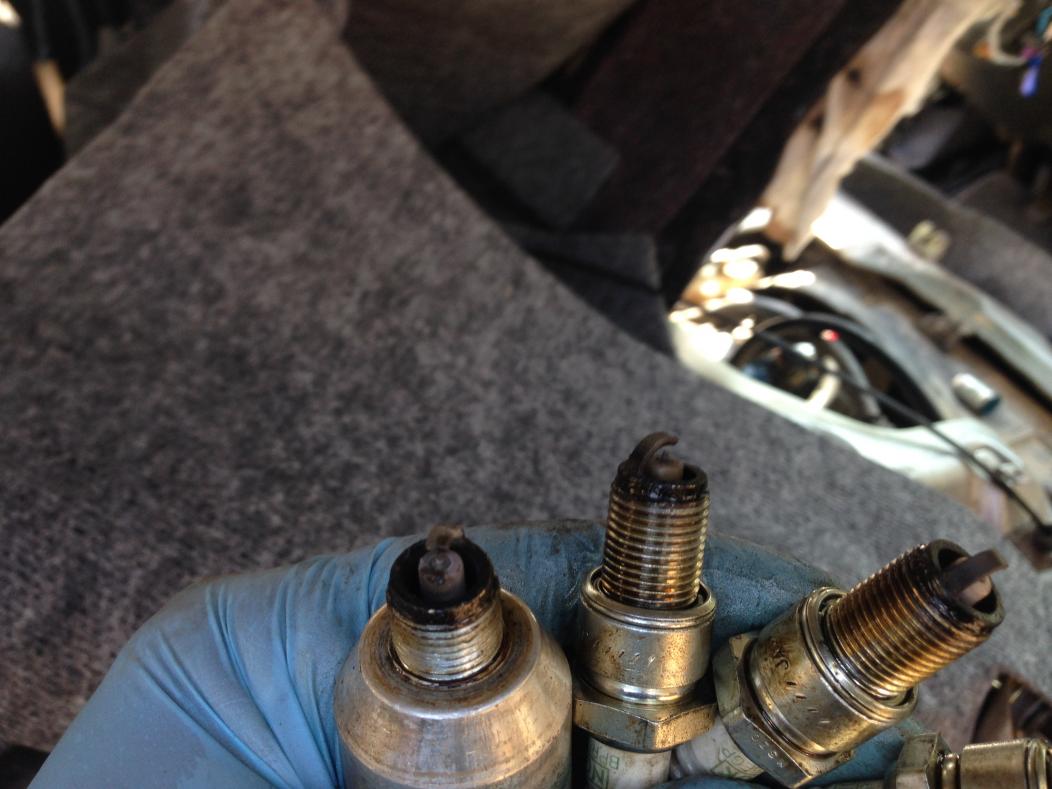

I pulled my plugs -they have 1200 miles on them. They all look a bit oily on the threads but not too sure what to tell from them. #1 plug looks same as the others with exception of #2 which was cleaner but I think I had a slightly loose cable.

Attaching plug pics - the one I hold by itself is #1, otherwise they are held with #4 on left hand side.

As far as "reading" plugs goes: they should be a light brown colour and be dry, grey indicates oil burning (often with deposits/build-up), black is usually from over-fuelling.
Both oil and fuel can cause the plugs to appear wet.
While it could just be the picture, yours do appear to be showing the signs of oil burning.
If there was oil in the tubes (that thing still on #4 plug) then replacing the tube o-rings can solve that issue, but I am seeing what appears to be oil down around the electrode area, not up above the compression washer. The only way that oil in the tubes could get down around the electrode area is if the spark plugs weren't actually tight.
Usually if the O-rings are bad, the tubes will fill with oil until it starts to degrade the rubber boots of the spark plug wires.
