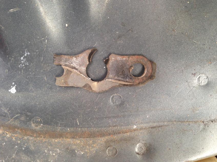

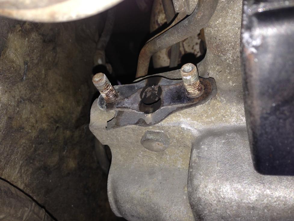

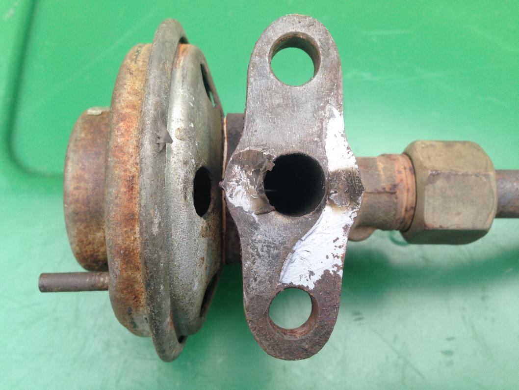

I had similar symptoms with a new TPS (installed by PO's mech). I removed the TB and reset the TPS. 51 still there. At the same time I suspected a vacuum leak in the area of the TPS. The big sucking sound got worse and worse, and worse. Finally I found it - bad EGR gasket. I fixed it and the code went away (van also runs MUCH better). I'm not sure if that jives with what we would expect, but my check engine light used to come on at highway speeds and it doesn't any more. I replaced the gasket and no longer have a code 51. FWIW, I also have my A/C belt removed. I'll also mention that the PO did not put in a Toyota TPS. Personally, I would have installed a Toyota TPS. I almost replaced it in an attempt to get rid of the 51, but all seems fine now. Here are a few shots of my bad gasket.
I'm not sure if there is a connection or not, but after repairing the EGR gasket I immediately got code 21 (O2). Replaced that (definitely expired) and 21 went away.
Attachment 2849Attachment 2850Attachment 2851
