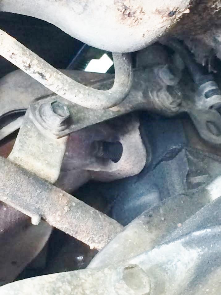

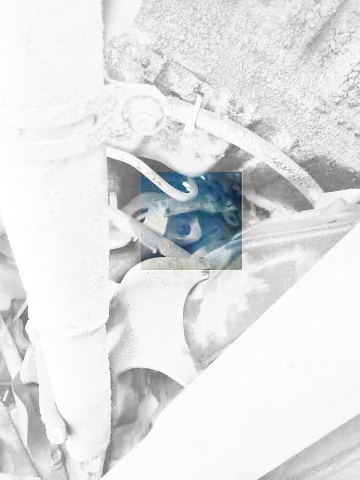

In meantime, I was looking around the day I was doing maintenance and saw I may be missing something important. I think its a nut that bolts the exhaust to the engine. Looking around I believe its part number 90179-10051 ? Maybe this could be contributing to how its running bad? I figure the nut hasn't been on there for a while... The bolt moves around a little bit by the way, not sure if it's suppose to be. Here's a pic:
Attachment 2170
Zoomed in:
Attachment 2171
Re: Issues accelerating after air filter & spark plug replacement
Looks like your exhaust manifold stud needs a nut. That won't make it run like crap, just loud and stinky.

Yeah, I'm actually surprised you still have that stud (they usually break off on vans with over 150k miles). I'm guessing you'll find a code 22 as your problem sounds like a failed water temp sensor. But you'll need to read the codes to verify before jumping into replacing that. Tim

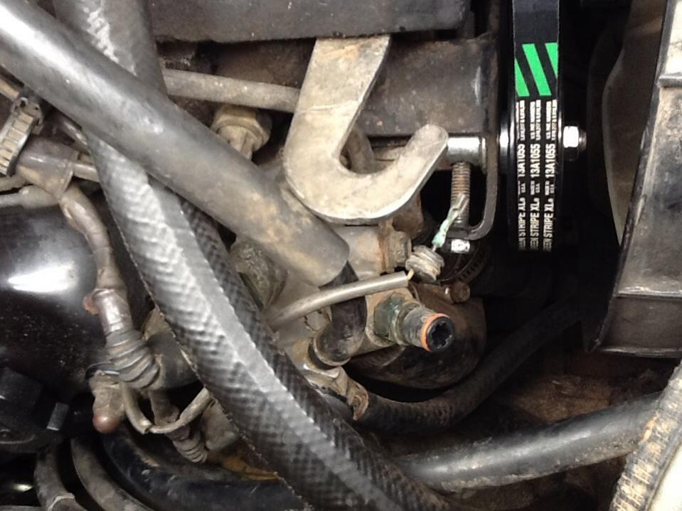

heres what I've got disconnected...I'm on the right sensor correct?
Attachment 2172
Sorry, some reason won't let me rotate pic...
Doh..ignore that q...I'm an idiot..sheesh. Wrong sensor...
Lol, yeah, wrong sensor. It's the next one clockwise to that. It's the one top of this picture with the green connector. Original poster incorrectly marked as "Temperature switch" (S/B ECU temperature sensor). Tim
