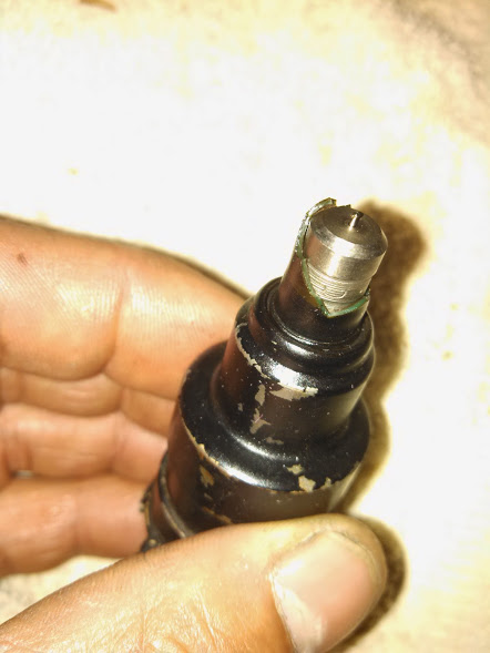

That part is called a pintle cap and it's easily replaced (by somebody with the right parts and tools). Any time you have your injectors out it's just a good idea to take them to an injector shop for servicing. I'm not sure about Reno, but here we have Dr. Injector. Their service costs $20 per injector. For that they will test and document patterns, flow rates, and leak test. Next they ultrasonically clean them, retest, & document. Assuming they pass, they will also replace the pintle caps, o-rings, and insulators. If you don't have a Dr Injector locally you can always send them by mail (funny because I just sent a set to him this morning). He will work his magic, then call for credit card info, then send them back. Here's a link to a thread where this is discussed: http://www.toyotavantech.com/forum/s...=4824#post4824. Tim

But tell them to leave the OEM injector screens.:wave1:

Yes, good point. I wasn't too thrilled with the screens they put in my last set. With the set I just sent them for servicing I included a new set of Bosch stainless steel screens (like originals) with a note to use them instead of the plastic crap they would otherwise put in there. The original style have more surface area and I think the mesh is slightly bigger. If your tank/fuel system is clean it probably doesn't matter though (my fuel system is/was contaminated so I want the old style). Tim

When I had my injectors serviced, one of them came back with that tip broken. I installed the injector anyway and it's never been an issue for the next 35,000 miles.

I guess not all injector service places are as thorough as Dr Injector. The one in Gladstone OR has always put new pintle caps on my injectors as part of the $20 (each) service. Tim

Hey coronan On this model of injector the pintel cap protects the tip of the injector and helps retain the lower seal between the injector and manifold. Dont worry about not having the metail filters. I do well over a thousand injectors a year and never have a issue with the newer style filter.
