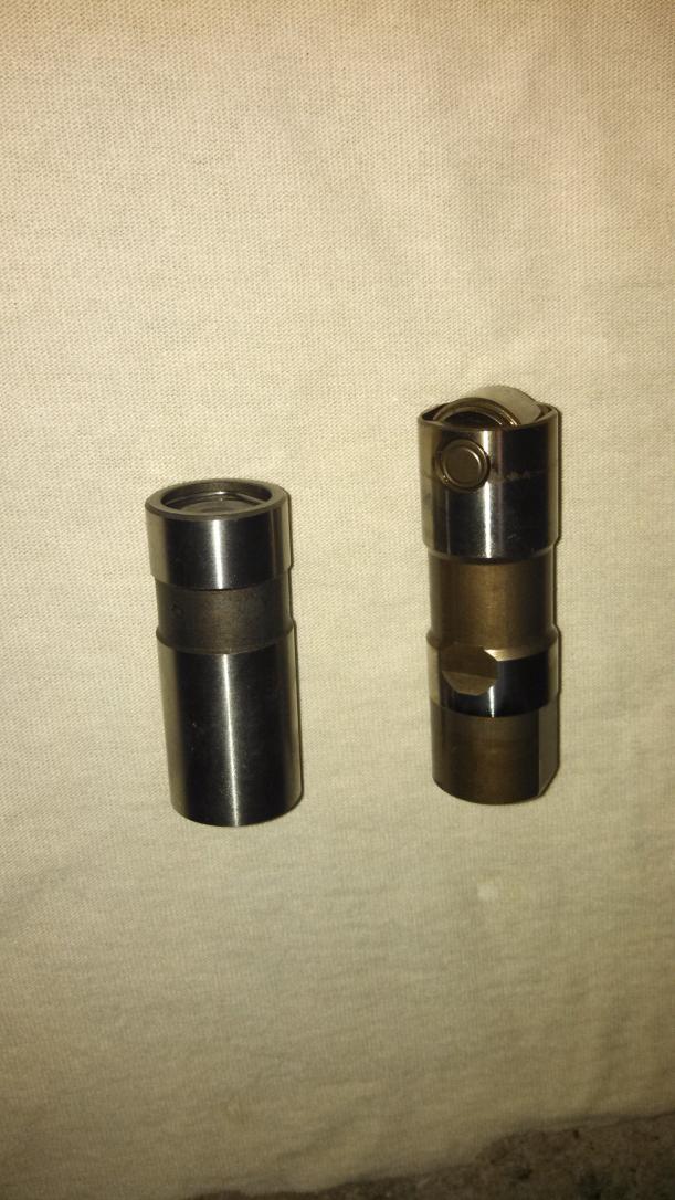

Attachment 1841
On the right is the one I removed. SUPRISE: its a roller, and the oil hole is in a different spot.
On the left is the one that is supposed to fit. Summit Racing: SUM-HT951.

That blows my mind too. Finding roller lifters in one of these is very interesting & I suspect somebody would have gone to a lot of trouble to make these fit/function correctly. Is this a roller on a solid lifter, or is it some sort of hybrid roller/hydraulic? Either one would blow my mind because I'm not aware of any such hybrids & solids would need to be adjusted periodically. Were there any mods to the rockers to make them adjustable?
Another point of interest is that roller lifter looks to be too tall. Does your engine have custom length push rods? (stock length is roughly 6 3/8"). As interesting as this mod is, unless you can figure out and deal with the adjustment issues, I would probably go back to stock. Of course this would mean a new camshaft, new lifters and likely a new set of push rods. Fortunately OEM push rods are still available & are actually cheaper than aftermarket (at least they were last time I checked).
As for stock 4y measurements, I have a few sets of well used OEM 4y lifters and a couple sets of new Enginetech #L6005-4 4y lifters. Taking rough measurements using a 6" caliper I read the same on both (used OEM & new AM). Dimensions are .842" outside diameter & 1.998" overall length. I didn't measure down to the push-rod surface, but they look to be identical. Distance from cam end to oil hole is 1.360" on OEM & 1.380" on AM. Tim

the rollers are hydraulic. I have them soaking in kerosene in hopes to rehabilitate them until i have my hands on some thing else.
2.600" tall
0.84" dia
1.785" cam to oil hole
push rods are stock. AND not bent.
sum-ht951 lifters match the stock dimensions.

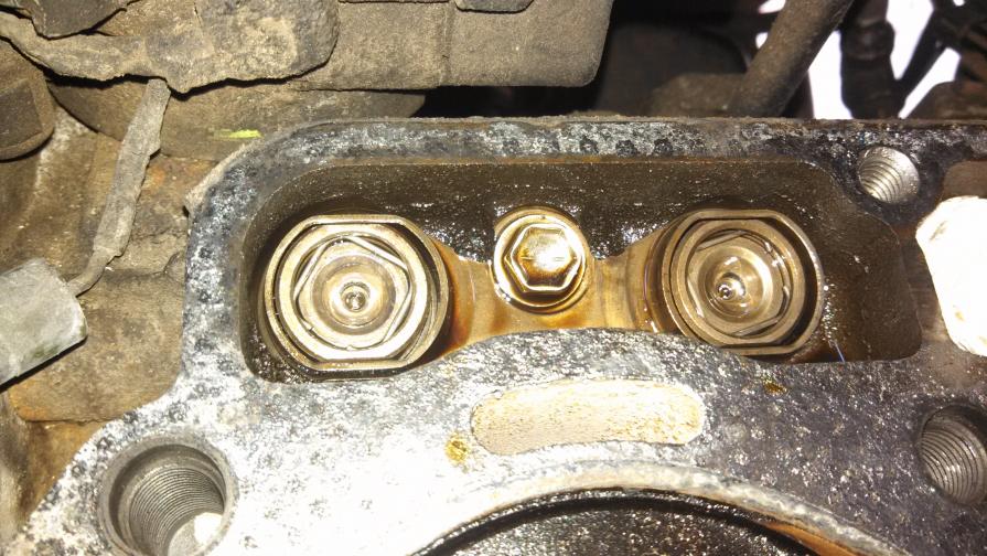

Below are The rollers installed in Cyl 1 at TDC Power Stroke. It looks SOOOO stock. Are you sure the 3y didn't use these? My bottom end is a 3Y.

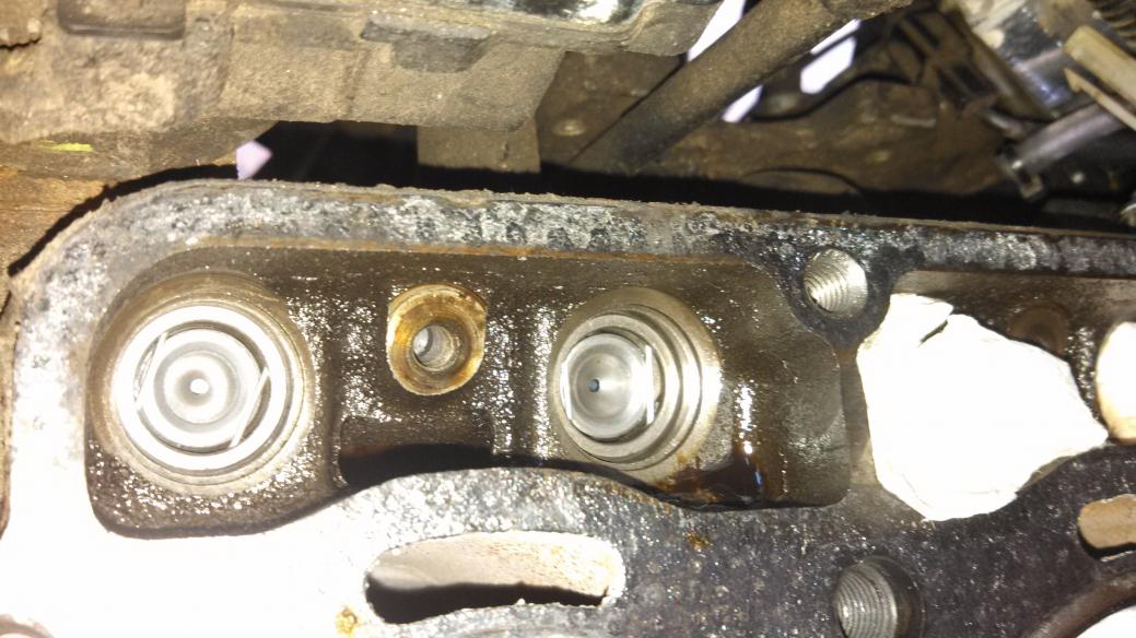

Now here are the summit HT951:
Attachment 1843
They sit MUCH MUCH deeper in the bore.

Did you notice the retainer that keeps the roller from twisting in the bore?
Is that tapped hole in the block for the bracket always there???
A flat tappet does not need that and is made to rotate in the bore for even wear.
Re: ROLLER VALVE LIFTERS??????
Yeah, I noticed it & that also threw me for a loop. I'm now thinking this has to be a stock set-up for this engine, but certainly not anything they did for the US market. I'm guessing that engine was built for a different market & imported here. I just took a look at a bare 4y block I have sitting here and the casting is different. There is no metal in the location where that bracket is attached, there is just a large (about 1") oil return hole there.
Based on this, I'm thinking I agree with your decision to try & find new roller lifters. If info isn't available I'd probably order 1 of those rollers from Summit and compare. If it's the same, then order another 7. Tim
