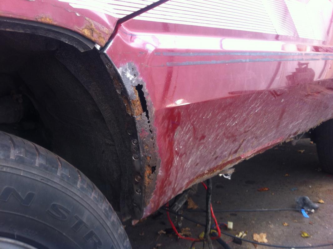

TVN - Speaking of rust, I decided to tackle the "little" hole on the drivers side rocker panel, I also have a little surface rust on the leading edge and I thought it would be a quick job to get out of the way before winter.
Here's a shot of the areas that are in question
Attachment 1152Attachment 1153
Doesn't look too bad, eh?

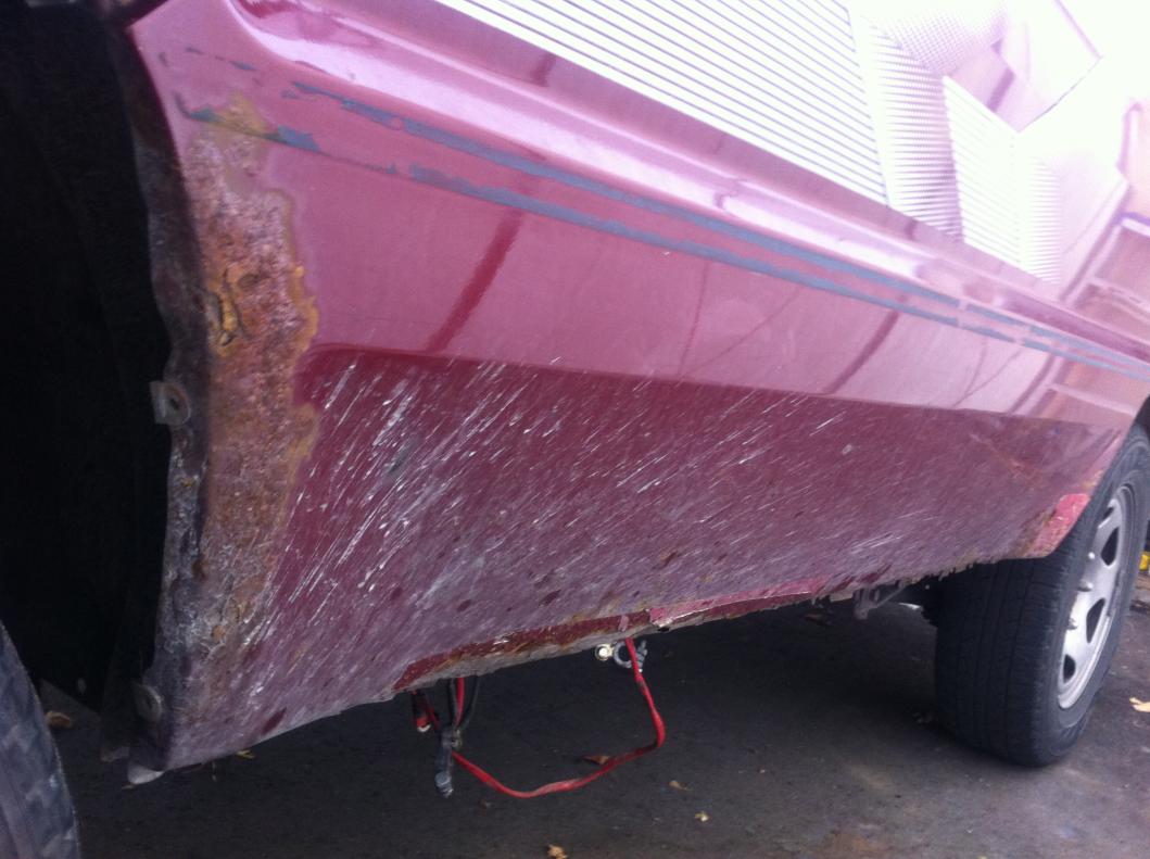

at least until I ran a wire brush over the "surface rust"
Attachment 1154

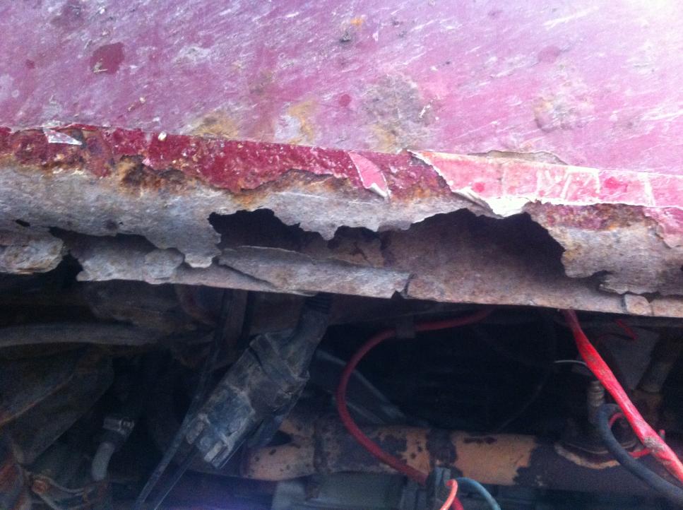

By the time I was done "exploring" this is where I ended up.
Attachment 1155
I was most amazed at the degree of rust on the inside of the panel, WAY worse than it appeared on the "good" side.
Bottom line is what I thought would be a 2-3 day repair has now stretched into 3 weeks and I am still taking things apart.
I don't think the pic really shows the extent of the rust but in case the pic isn't clear, the lower 3in of the inner rocker is toast, as are the body support members that attach to the bottom of the inner rocker.

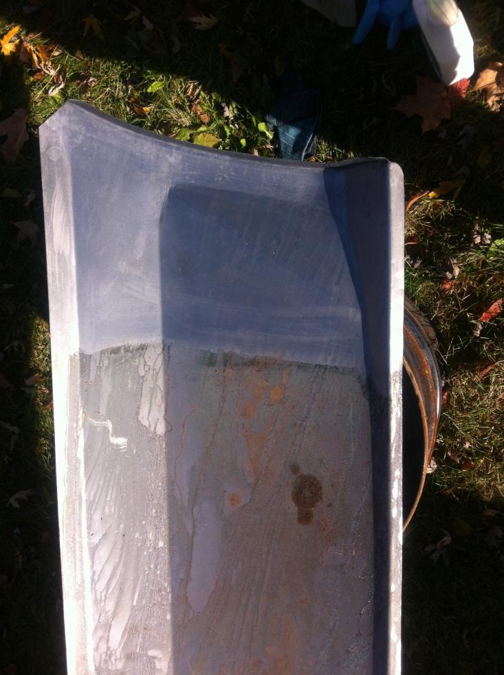

Some years ago I picked up an aftermarket LS rocker panel, while it was far from pristine at the time, 3 years in my shed hasn't helped much.
.Attachment 1156
I forgot to take a "before" pic on the "outside" but I think you can get the idea from the portion I have started on, on the backside of the panel.
Basically it is a matter of wire wheeling the surface to remove as much rust as possible.
Then spray down with the ospho and scrub (I used steel wool but scotch pads are recommended) scrub till the rust dissolves and just keep going.
Once your happy, wipe off the excess and let dry for 24 hrs. Next day, any remaining rust will appear black.
I am not content to assume that the converted rust is sufficiently dealt with so I keep repeating the process until no more black appears, then I know I have truly eliminated the rust and I can apply epoxy primer to seal the panel.
